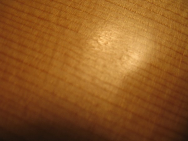

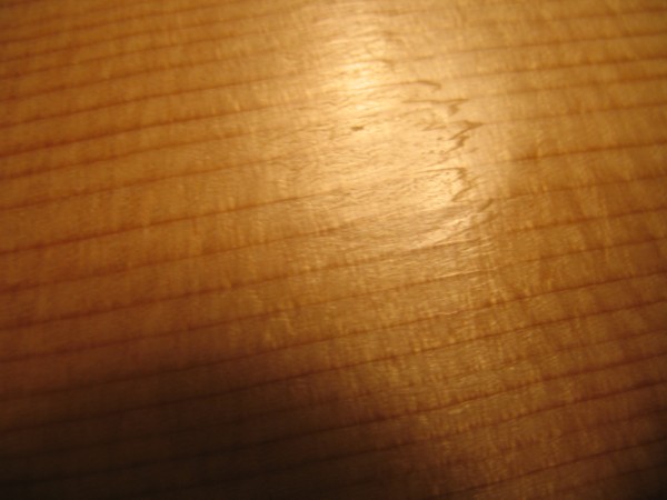

So I started buffing with a 8" buffer at 1725 rpm using, tripoli bar that came with the buffer and noticed a few of these.
I hope you can see them well, I zoomed in as much as i could.
I think the shellac melted and piled up in ridges. But if so why.
Was it too soon? Did I apply too much pressure, I thought i was not heavy handed? Is the tripoli compound to aggressive? All of the above ??
I tried another wheel with "white diamond" compound and did get a nice luster without any of the shellac melt sandwiches, but I also moved faster and went lighter pressure. I was scared.
Good thing I can sand it off and try again,, but would like to get it at least closer to right next time.

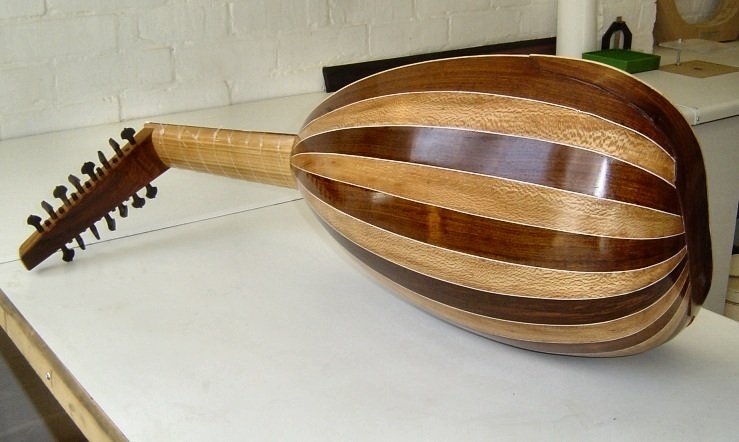

No Mike just your bare hands, rather like polishing an oil finished best shotgun. Just rub your palm and heel of your hand over the finish, it may even become uncomfortably warm. Yes it finishes with a nice shiny lustre without being too glassy looking, not a finish I like. By the way I have never levelled with abrasives of any type, after bodying, if done carefully and glazed properly that shouldn't be necessary. I believe Frank Ford does something similar.
This is what it looks like shiny and rich without being plasticy looking. In fact it looks French polished.

Colin, beautiful Lute,, nice to see it again, the finish is fantastic.. But I don't believe I ever asked how to make an instrument look that good!! ..

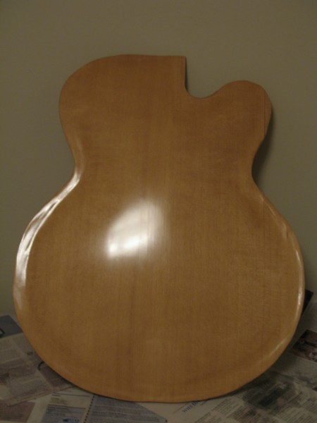

I leveled before I glazed, but I really don't think I needed to.. But after glazing I did have some streaks, visible mostly in the Walnut back.. I tried the hand rub/poor mans buffer method and it does look great. As you probably already know,, I still have the streaks. How do I glaze and not get those. drier muneca? More pressure..It feels as though they are very slight ridges. That if why I suspect it was too wet?

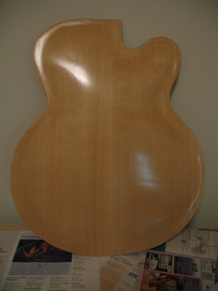

well i was able to sand out the top to remove the defects, then applied two more bodying sessions and reglazed. I think th e glaze came out much better this time, and in a few days I will polish it, i will start with hand rub, and possible go on to liguid polish by hand. The photo is with just one overhead light, no flash.

A couple things. First I am not sure what grit Tripoli bar is but I really recommend Menzerna compounds. For French polish I use fine and extra fine. Second the damage in your photo shows either excessive heat or excessive pressure. I buff fine Menzerna at 800 rpm and extra fine at 1100 rpm with my belt tension set so that if I dog the part to the buffs the belt will slip and the buff stop.
If buffing a French polish that has been glazed well you will not need much pressure against the buff at all. Time is not the issue at all you can buff shellac same day if you do it right. In fact if you spirited between every body session after the second, and achieved a level surface with out needing to sand to level, you can glaze to a high gloss without need for buffing. Keep in mind that a high gloss glaze will not happen in just a few glazing sessions. If you pay attention to the reflections in the surface you will know that your there when a reflection of light bulb is in true focus on the surface of the guitar. At that point all you would need is a polishing compound like 3M finess-it and no need to high speed buff.
If you want to buff it, keep the pressure moderate, keep the buffs moving to reduce heat build up and use only fine and extra fine compounds.MichaelP38985.419849537

MikeV, the photo you sent shows a reflection of a work light that is fuzzy around the edges. When the glazing is complete the reflection will have no fuss but be a completely in focus image.MichaelP38985.6700347222

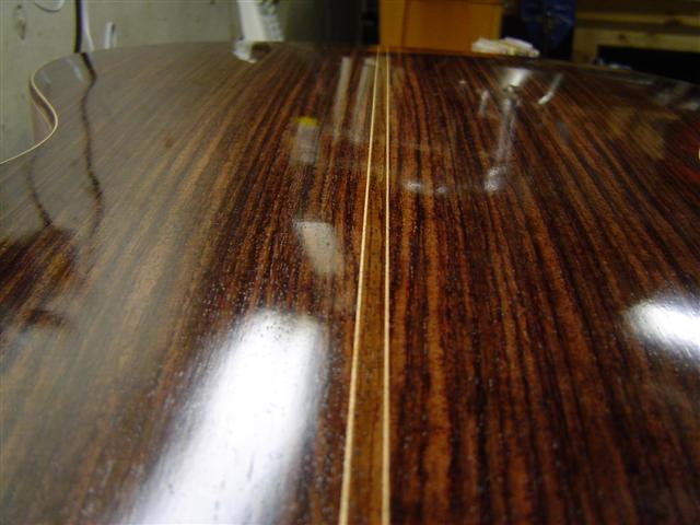

When I French Polish I can go to my buffer within a few minutes and buff it out to a high gloss. The pic is an example. My buffer is much higher than 1750 RPM's too. Keep the guitar moving and use light pressure. I use menzerna very fine to get the gloss.
You can also do it by hand using Menzerna swirl remover and a soft cloth. The result is the same and it doesn't take much time to get it to a high gloss. It is also much safer if you don't have much practice on your wheel.
Like Jon said, we learned to use the drill press and a small buffing wheel in the Brune class. I prefer my buffing method as I melted my finish in the class!
